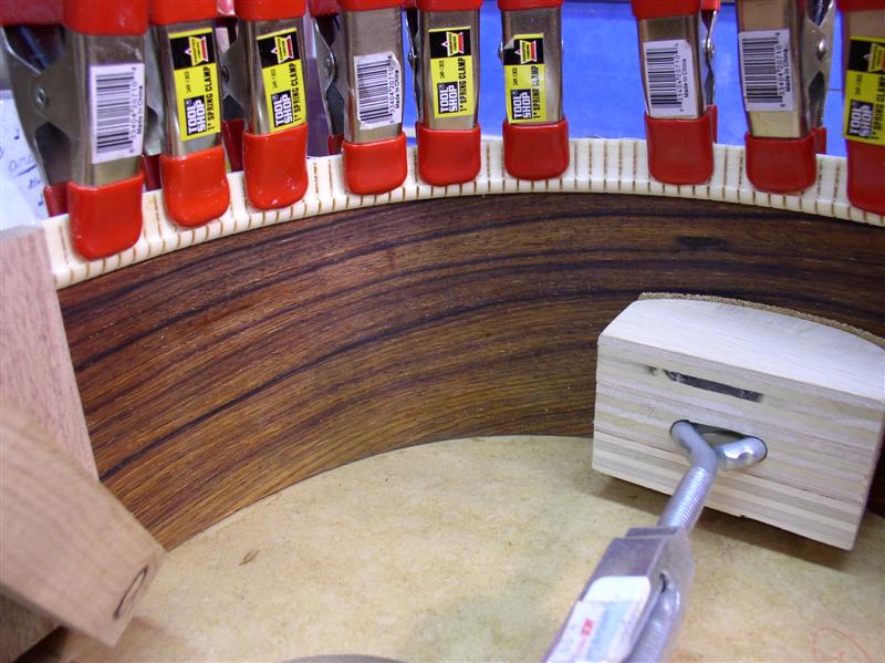

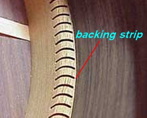

Some thing in the picture that Lance post I found interesting is the revers kerf linings have what looks to be a .002-.004 backing strip That is pretty cool in my book. Makes for a closed kerf system. I like it
PostPosted: Wed Jul 11, 2007 4:16 am
Michael these liners are Charles Fox style two piece capped linings. You install the piece with the kerfs first, then you come back and install a solid piece that covers the front of the kerf.
PostPosted: Wed Jul 11, 2007 4:19 am
Here is a set before the cap was put on.
PostPosted: Wed Jul 11, 2007 4:47 am
I was aware of the Fox linings but I guess I was just looking at the picture wrong . To me the picture appears to have a joint line on the back side of the kerf. I guess it is just an illusion
